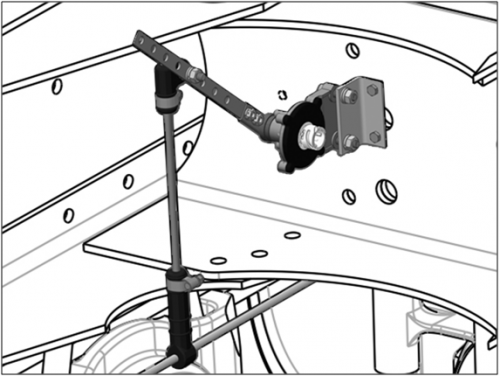

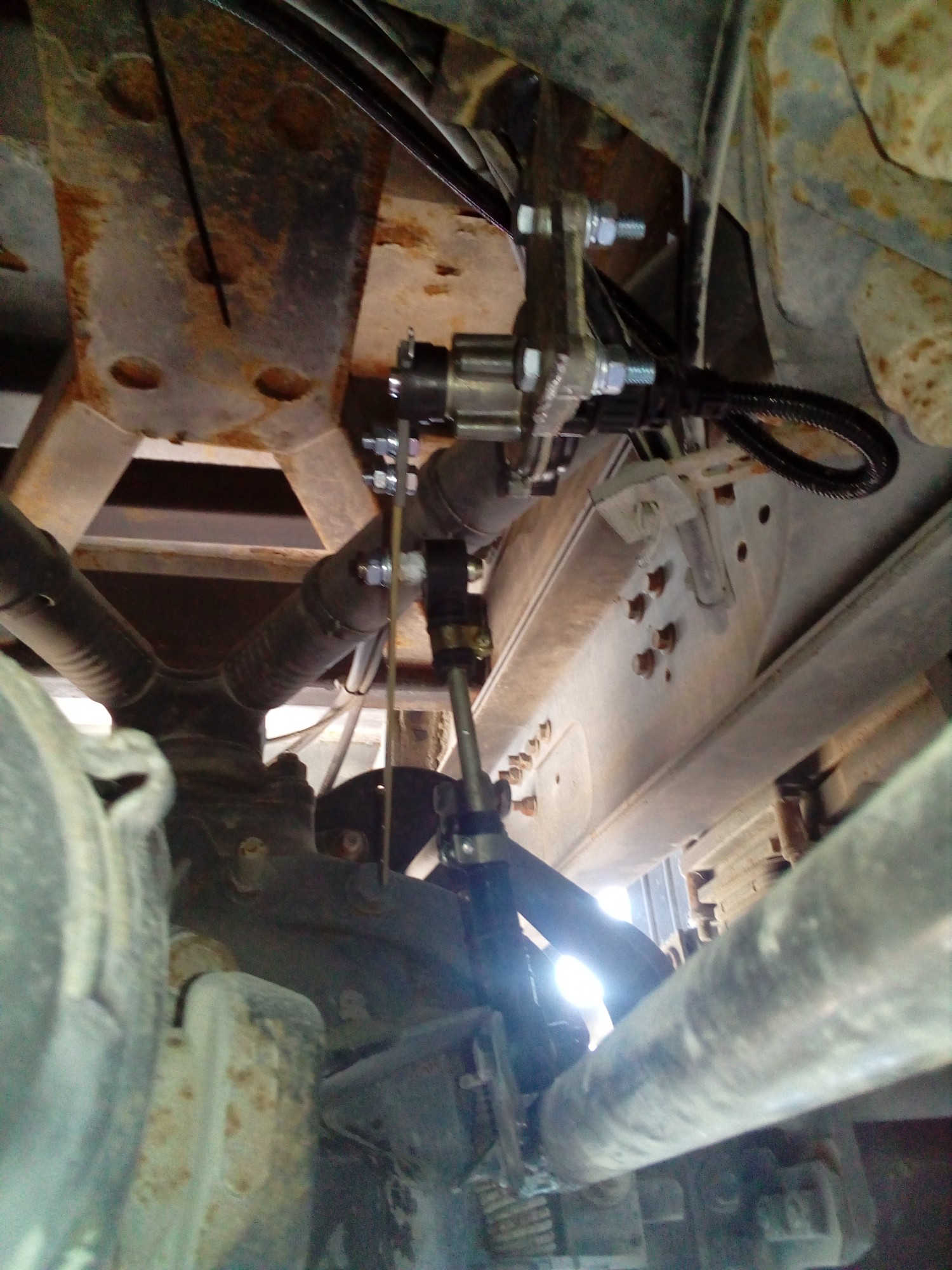

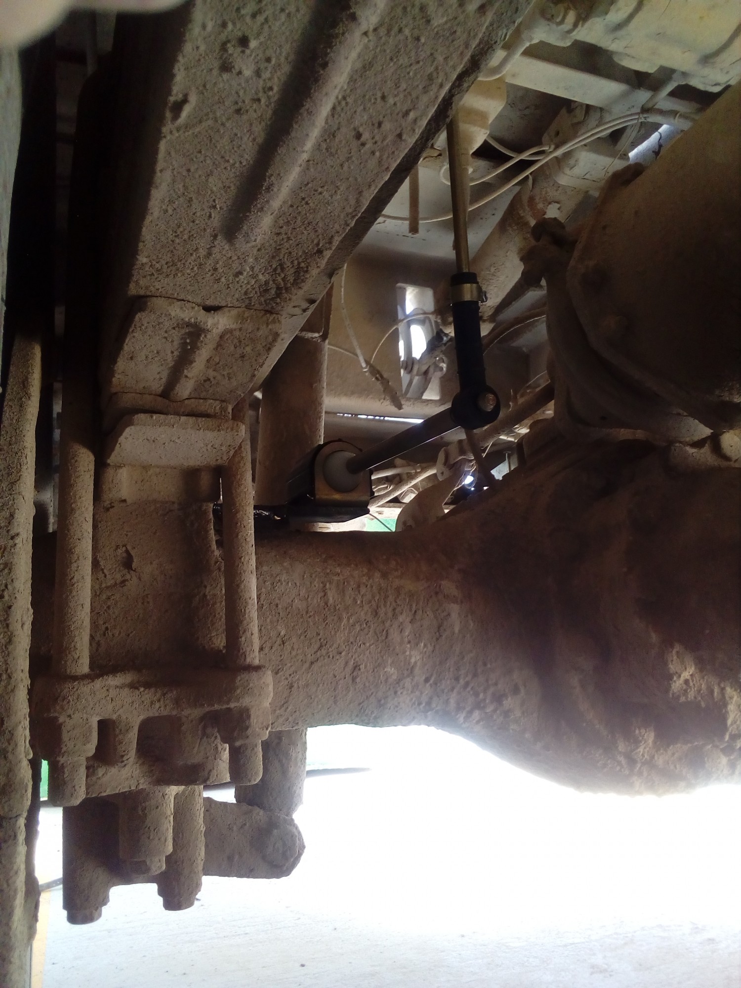

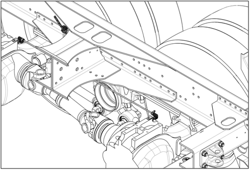

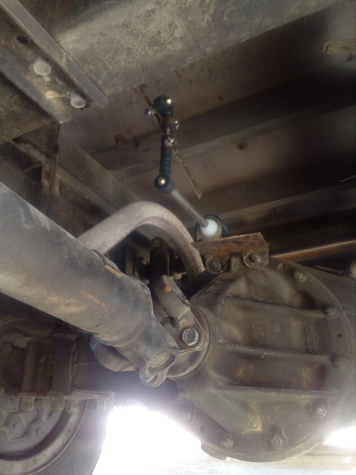

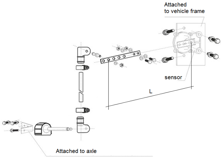

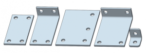

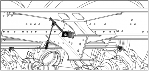

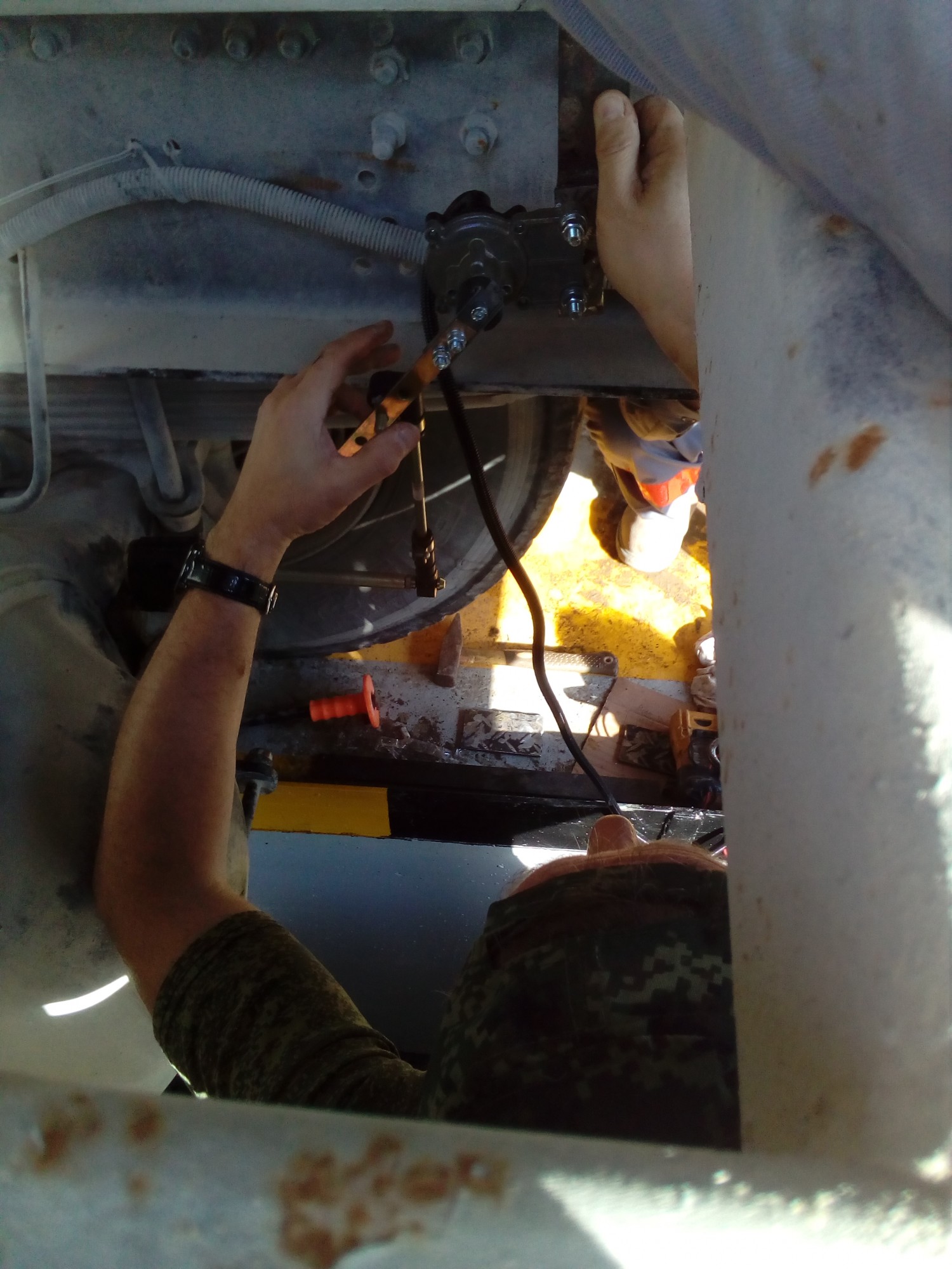

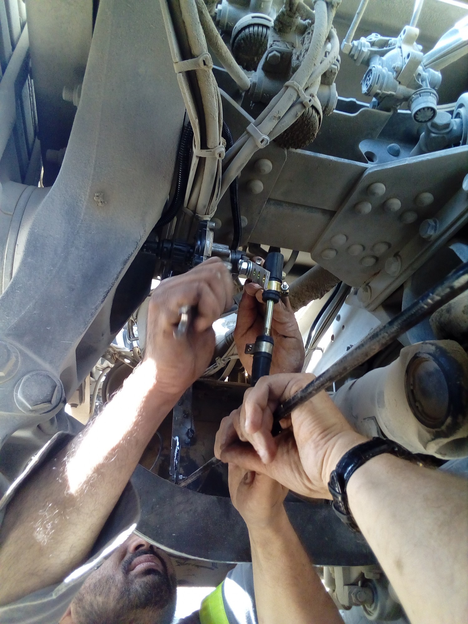

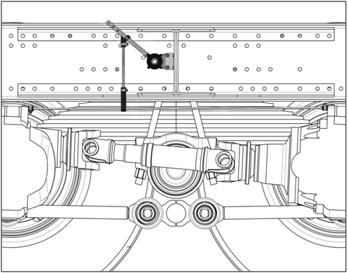

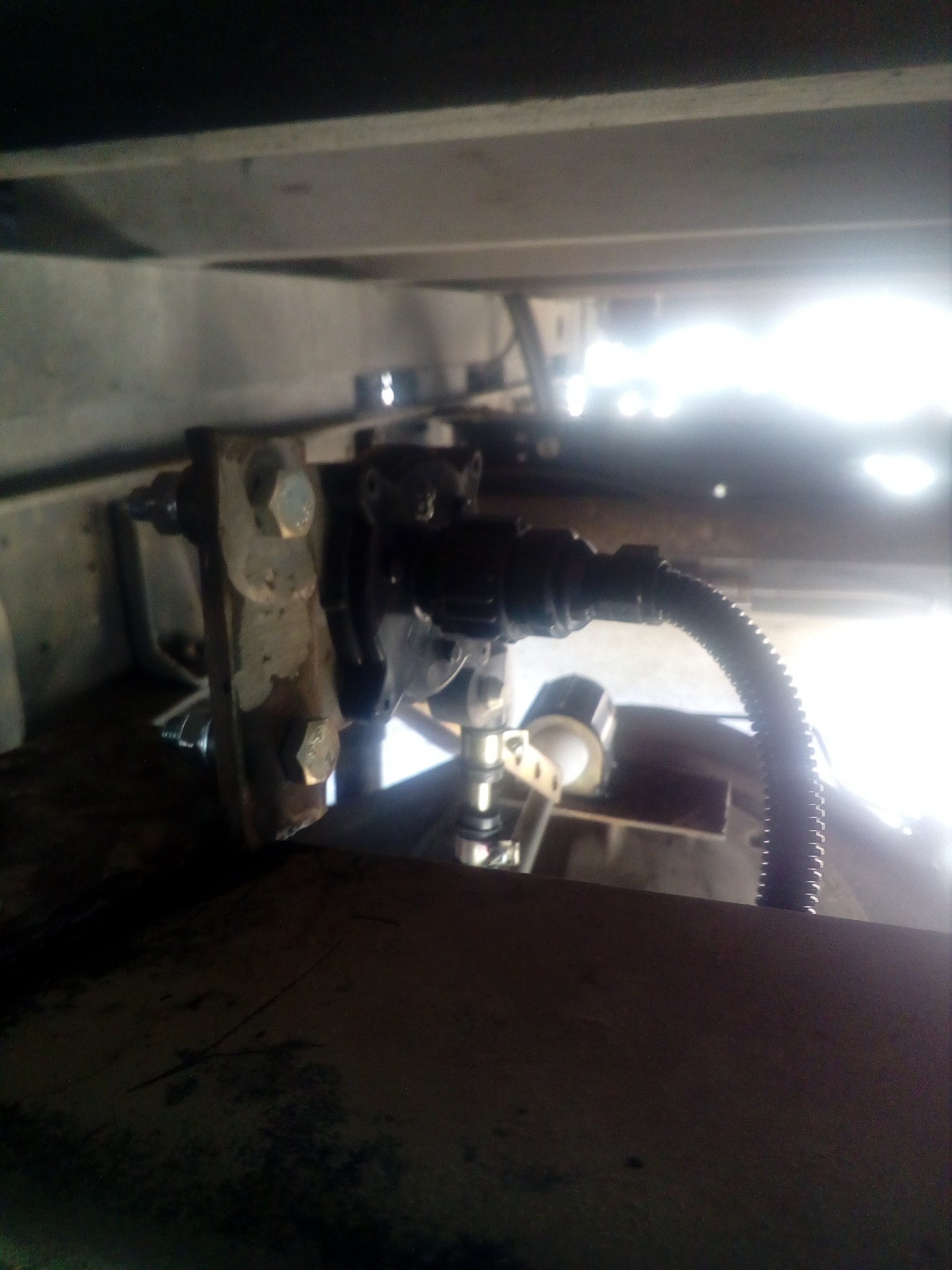

Eurosens Difference 02 applies to vehicles with leaf spring suspension. Can be installed on two-axle or three-axle vehicle, installation will be simple with an installation kit.

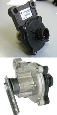

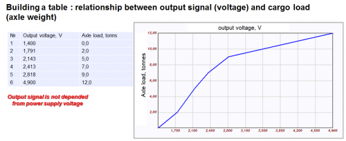

Eurosens Difference 02 in fact is resistive position sensor and is designed to provide information on the distance between the body and the axis of the vehicle. Measured value is proportional to axle load of vehicle.

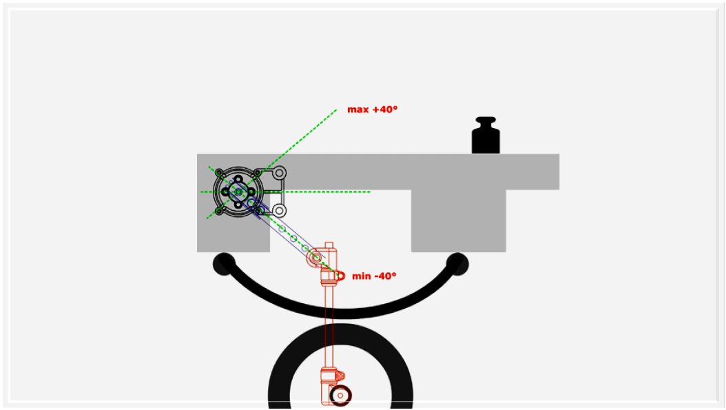

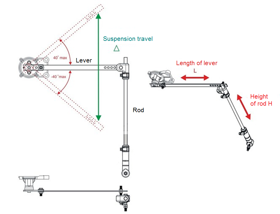

Rated supply voltage Us = 24 V. Output sensor voltage at the control points depending on the lever angle specified in Table 1.
Lever angle, degrees Output voltage, V
0 1,54
10 1,78
20 2,02
30 2,26
40 2,50
50 2,74
60 2,98
70 3,22
80 3,46
It is important to observe when installing the sensor permissible angles of its lever movement.
