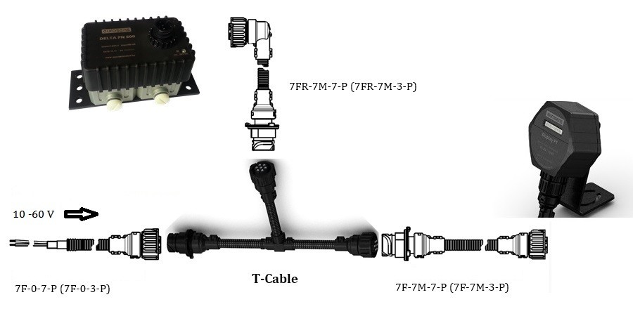

For connection you can use standart cables from Mechatronica:
Connection to differential fuel flow meters Delta:
Connect_Display_Delta

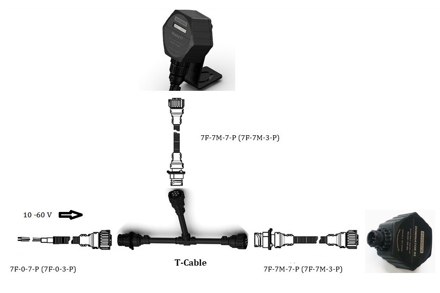

Connection to fuel level sensor Eurosens Dominator:
Connect_Display_Dominator
