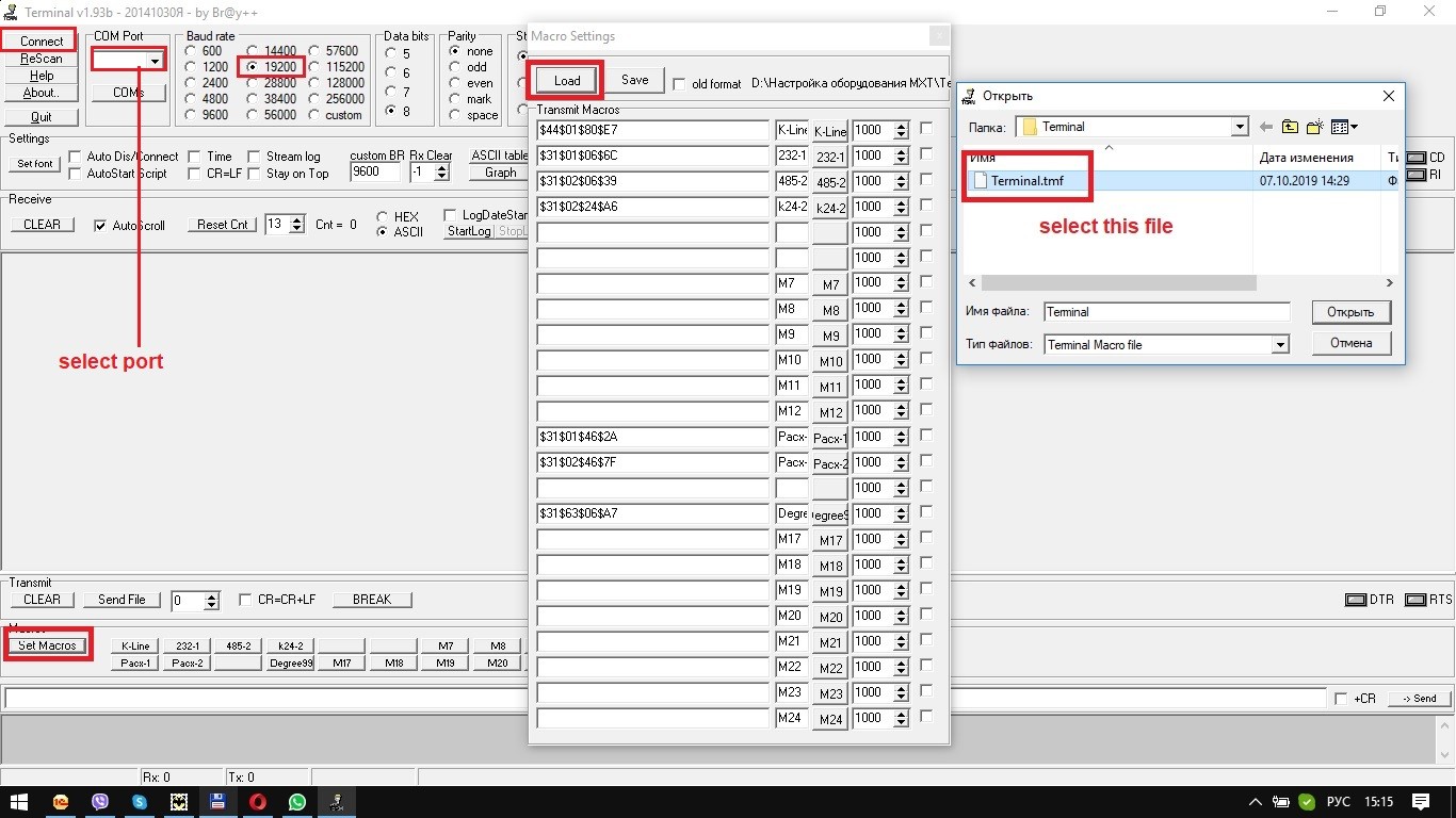

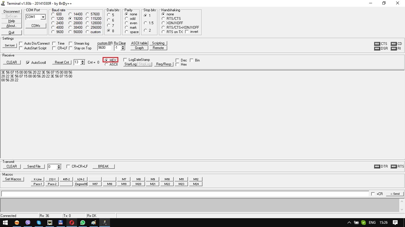

Laptop and Eurosens Destination 02 adapter is needed
Connect sensor to adapter and adapter to USB port.
Download Terminal.exe software
http://easyelectronics.ru/files/soft/Terminal.exe
