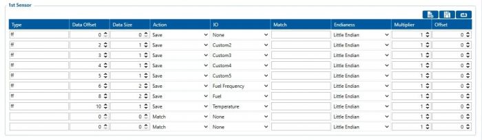

Тема: Tilt angle sensor Eurosens Degree BT with Teltonika FMB over Bluetooth
Teltonika GPS trackers should have Bluetooth Advanced settings  (section Bluetooth 4.0 - Advanced )
Settings to read the Eurosens Degree BT sensor
https://forum.mechatronics.by/uploads/images/2022/01/d81c4c579ba412901c560f8ad83626f3.jpg

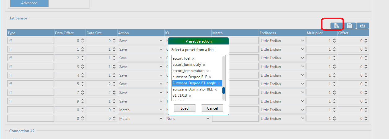

To save your time you can download attached xml-file and copy it to your My Documents/Presets folder of Teltonika  configurator.
After this procedure Eurosens Degree BT sensor appears in presets:
Bluetooth-presets
