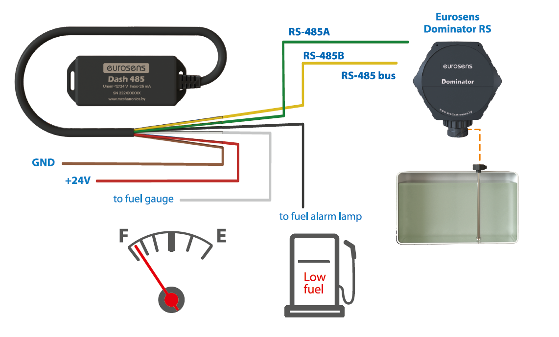

Eurosens Dash resistive fuel level sensor emilator is designed to control the fuel gauge on the dashboard. Eurosens Dash reads the fuel level (volume) value via the RS-485 interface and the LLS protocol.
A typical application of the device is when installing a capacitive Eurosens Dominator RS fuel level sensor instead of a standard float resistive sensor of a truck directly into its hole. This eliminates the procedure for drilling the tank. In this case, the Eurosens Dash emulator is connected in parallel with the GPS tracker.
Eurosens Dash also generates a signal to control the low fuel alarm lamp.
