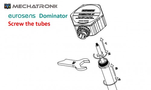

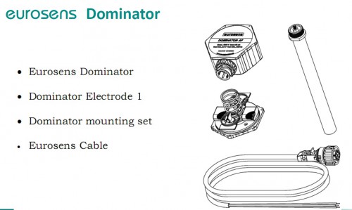

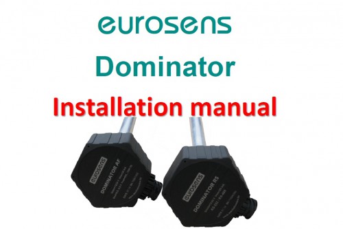

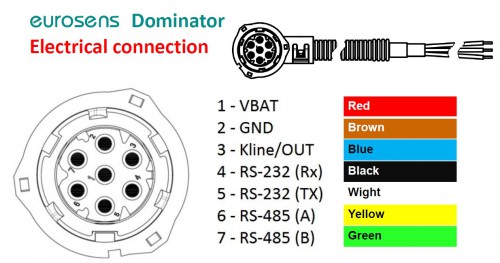

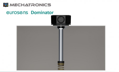

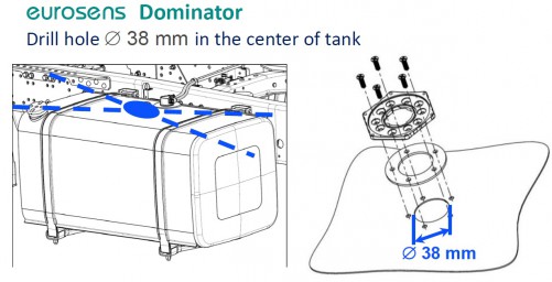

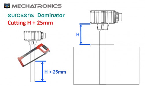

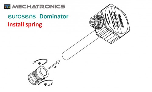

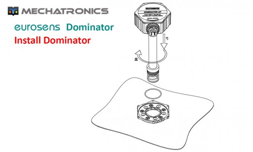

Fuel level sensor installation - Eurosens Dominator
