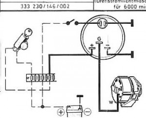

Easiest way to measure RPM data - connect tachomenter input to the suitable DTM3 input (IN0_D)
You just need to find tachometer connector with actual voltage from alternator
G connector :![]()

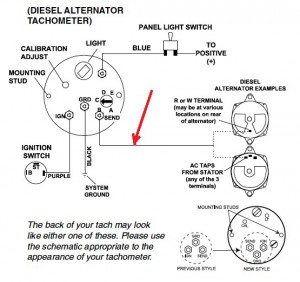

If vehicle doesn't have tachometer - you need to find "W" output from alternator:![]()

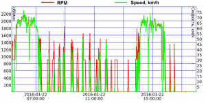

Result in AVL tracking platform:
