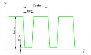

About shape of pulse output
Direct P flow meter (simple scheme with reed switch).
Direct P meter pulse shape
Vbat - supply voltage (usually 12 or 24V)
Uhigh=0.9*Vbat
Ulow=0.7Volt
timing data:
table direct P

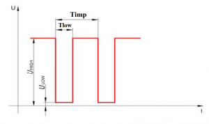

Direct PN flow meter
Direct PN pulse
Uhigh=0.6*Vbat
Ulow=1.4Volt for Direct PN100, PN250, PN500
Ulow=0.7Volt for Delta PN100, PN250, PN500
table PN
