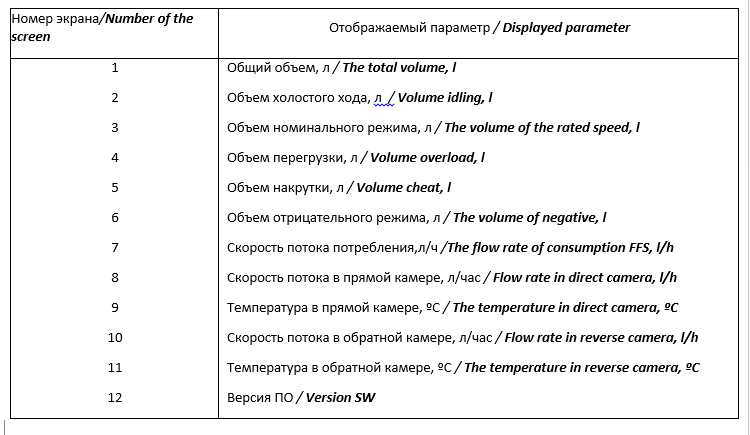

			<title><![CDATA[Re: Fuel consumption meter Eurosens Delta RS + Display RS + GPS tracker]]></title>
			<link>https://forum.mechatronics.by/post765.html#p765</link>
			<description><![CDATA[<p>When everything is connected we could see data on Display RS</p><p><span class="postimg"><img src="http://forum.mechatronics.by/extensions/img_bbcode/uploads/Display_RS_flow_meter_data_7567707831.png" alt="Display RS flow meter data" /></span></p><br /><p><a href="https://youtu.be/L1uTqTW4FVg">https://youtu.be/L1uTqTW4FVg</a></p>]]></description>

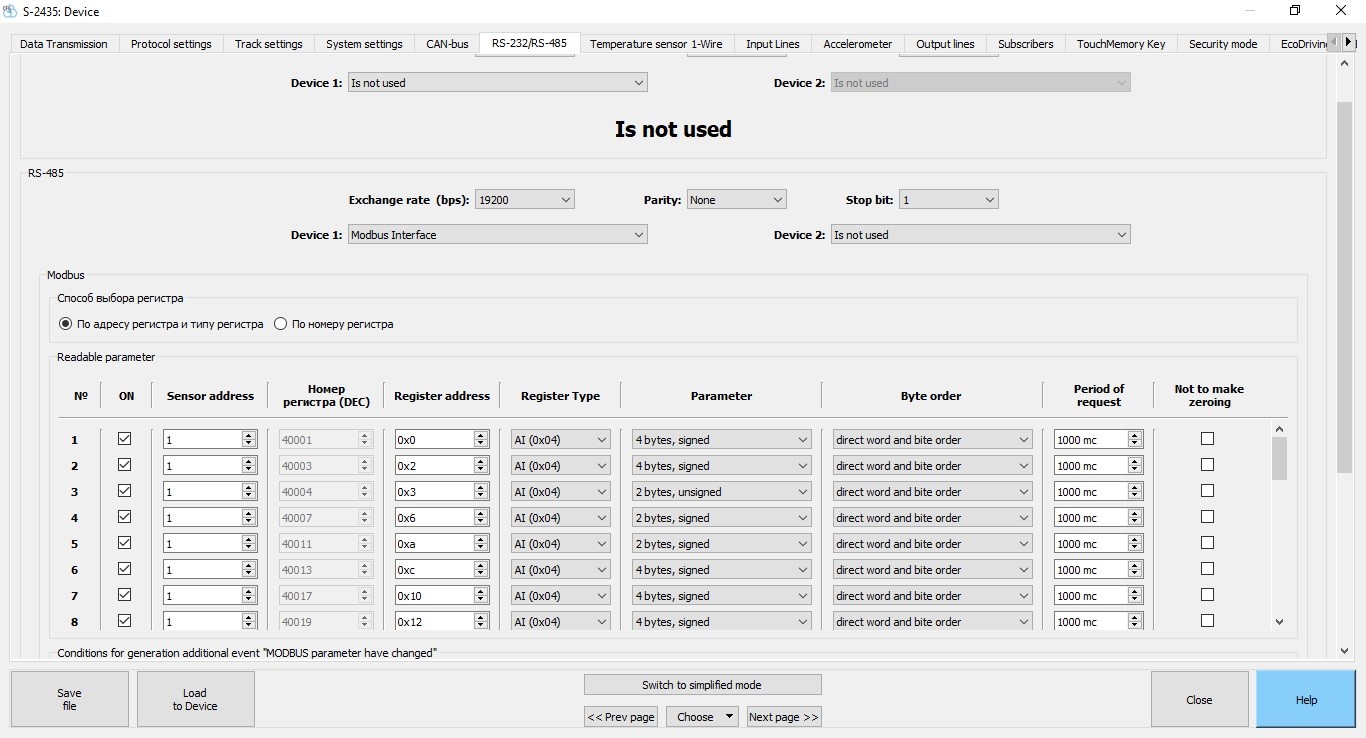

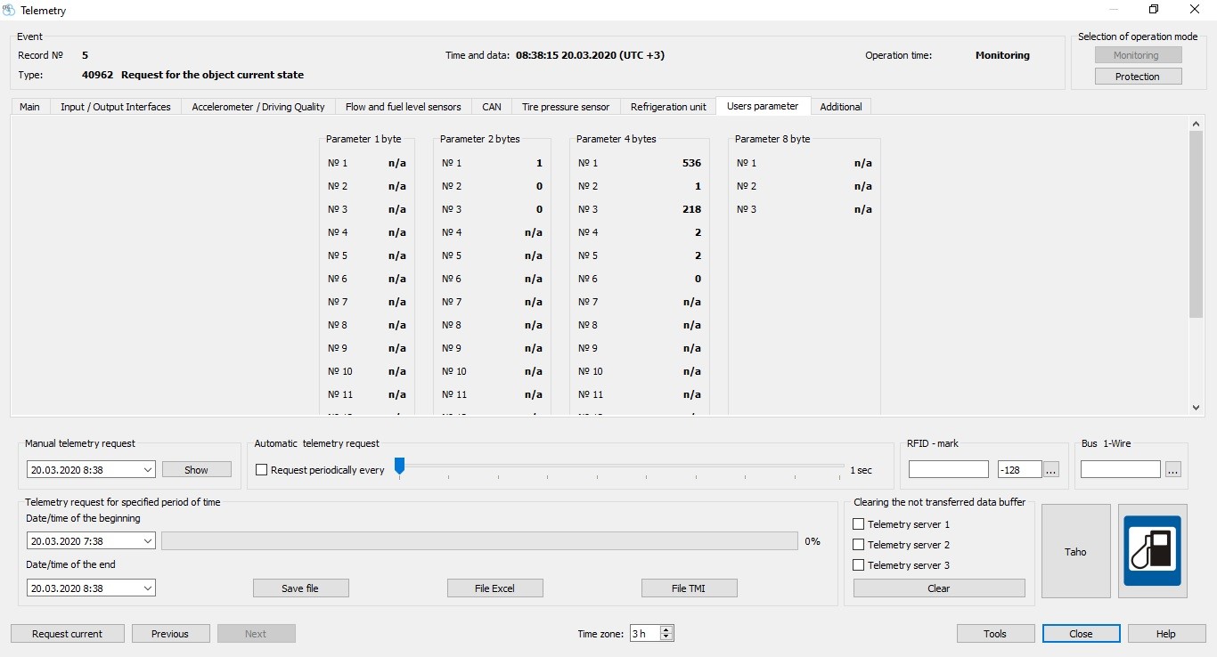

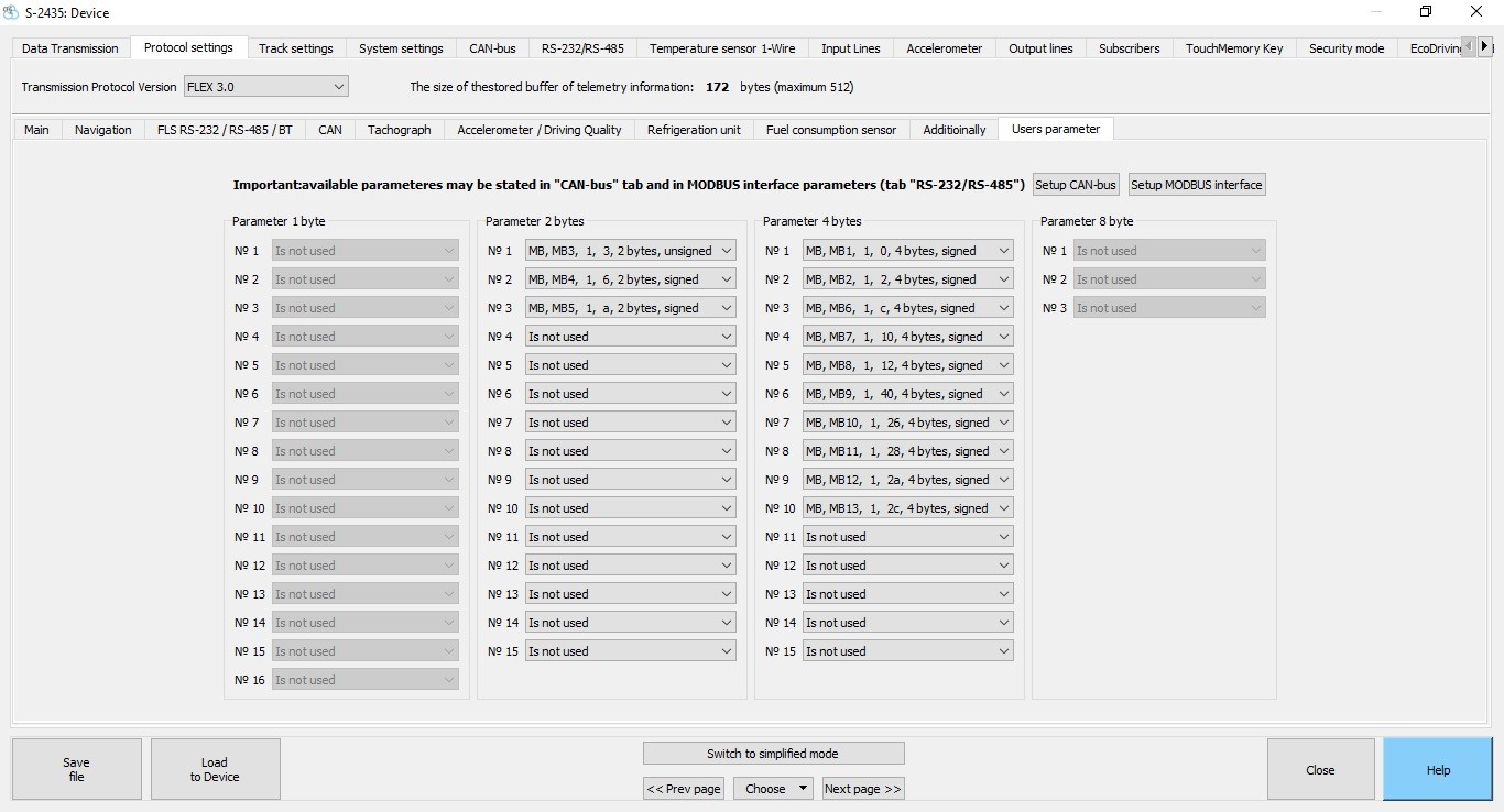

			<link>https://forum.mechatronics.by/post764.html#p764</link>
			<description><![CDATA[<p>GPS tracker settings:</p><p><span class="postimg"><img src="http://forum.mechatronics.by/extensions/img_bbcode/uploads/smart_2435_2011747681.jpg" alt="smart 2435" /></span></p><p>MODBUS settings:</p><p><span class="postimg"><img src="http://forum.mechatronics.by/extensions/img_bbcode/uploads/smart_2435_setting_ModBus_4686765363.jpg" alt="smart 2435_setting ModBus" /></span></p><p><span class="postimg"><img src="http://forum.mechatronics.by/extensions/img_bbcode/uploads/smart_2435_user_parametrs_3468317436.jpg" alt="smart 2435_user parametrs" /></span></p>]]></description>

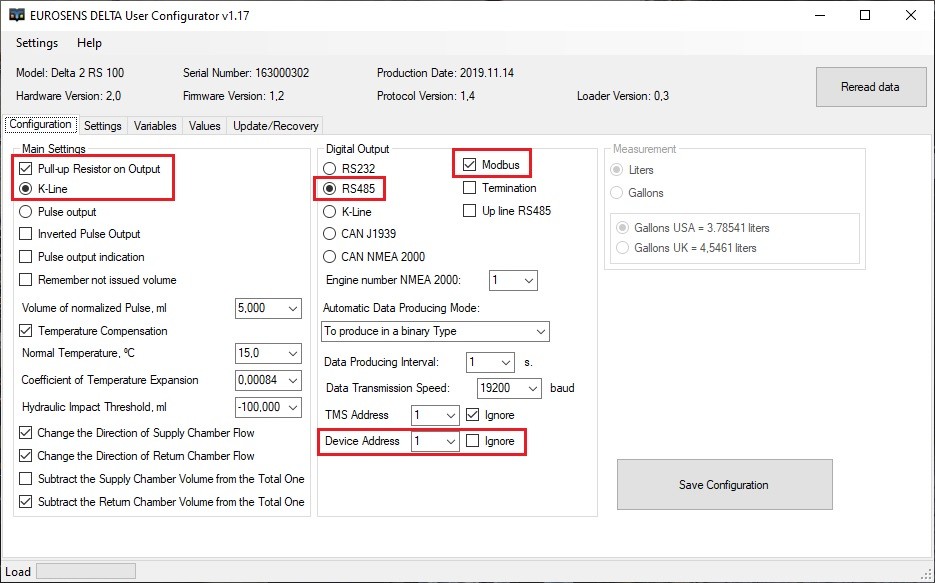

			<link>https://forum.mechatronics.by/post763.html#p763</link>
			<description><![CDATA[<p>Fuel meter configuration</p><p><span class="postimg"><img src="http://forum.mechatronics.by/extensions/img_bbcode/uploads/Config_DeltaRS_4346716674.jpg" alt="Config_DeltaRS" /></span></p>]]></description>

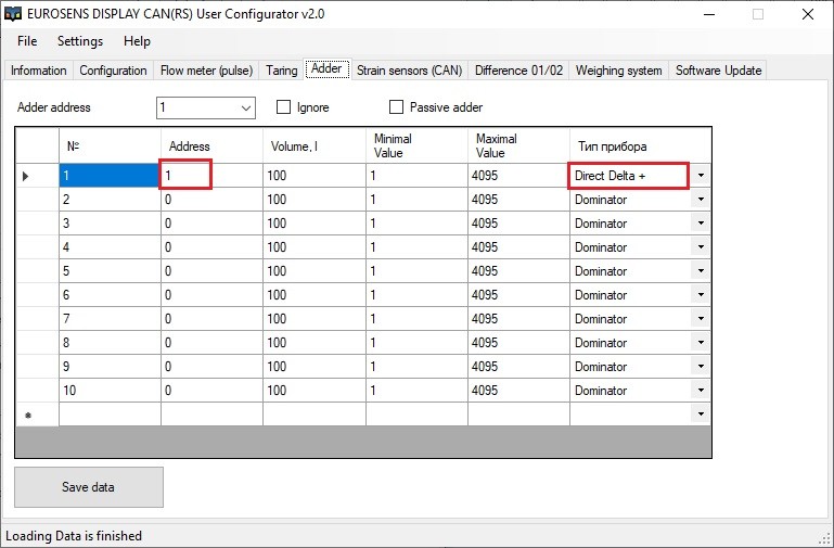

			<link>https://forum.mechatronics.by/post762.html#p762</link>
			<description><![CDATA[<p>Add device type - Direct, Delta flow meter in the Display Adder section</p><p><span class="postimg"><img src="http://forum.mechatronics.by/extensions/img_bbcode/uploads/DisplayRS_Adder_6558608990.jpg" alt="DisplayRS_Adder" /></span></p>]]></description>

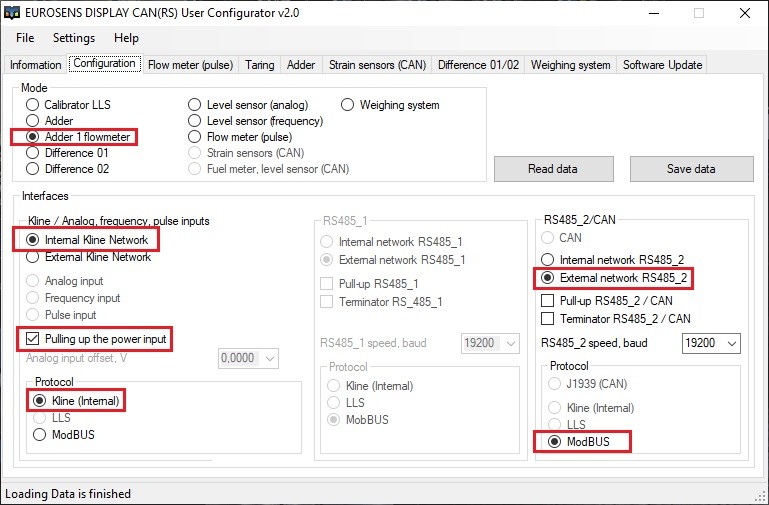

			<title><![CDATA[Fuel consumption meter Eurosens Delta RS + Display RS + GPS tracker]]></title>
			<link>https://forum.mechatronics.by/post761.html#p761</link>
			<description><![CDATA[<p>We want to fuel consumption meter Eurosens Delta RS to onboard Display and GPS tracker Smart 2435 using RS485 MODBUS interface</p><p>How to do that.</p><br /><p>Display settings:<br /><span class="postimg"><img src="http://forum.mechatronics.by/extensions/img_bbcode/uploads/DisplayRS_Config_3657271564.jpg" alt="DisplayRS_Config" /></span></p>]]></description>
